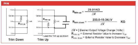

I'm using the same DC to DC and have no problems at all just be sure to heatsink it well. Also it needs a cap across its output to eliminate ripple and a annoying high frequency whistle. My voltage is 48 56 hot off the charger. I'm wondering if it will work with a 72 volt pack because a 72 volt pack is 84 hot off the charger

No 7 amps is the Max current draw on the input. The out will do 20 amps at 12 volts I have used it almost up to that limit
Here is the connection picture I added a 1000uf electrolytic cap across the output. I also trimmed the uinit to 13.8 volts cause I use it to charge a Aux 12 volt battery
I connect the sense wire to the output pins at the unit just jumped across the pins with thin wire 22AWG wire and 10AWG to the load
