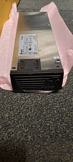

I just bought two Delta DPR 3000B 48V
3kw 96,2% max efficiency
41x82x265mm 1,3kg
42-58V programmable output, the value can be safed in the rectifier.

The Delta is the one on the left side. Middle Vertiv R48-2000E3, right Eltek Flatpack S
I also tested them with an electronic load.

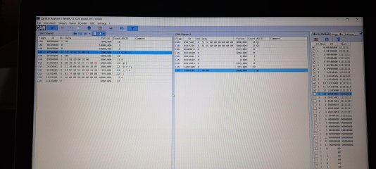

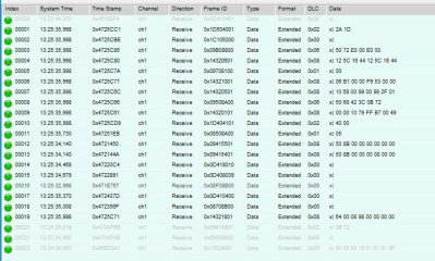

Here are some screenshots from the merged protocoll
Float Charge 58V
Float Charge 48V
Float Charge 42V

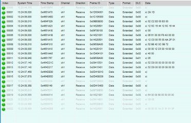

This is the data sent from the rectifier for measured output voltage (42V)
Same for 48V

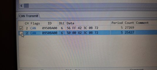

Now I moved a little forward
I can change the voltage, but only by overwriting the values sent from the PSC3 System Controller, the controller itself has still to be running.
Voltage can be changed between 58,15V and 42,2V
56 AF and higher values give 58,15V
50 69 and lower give 42,2V.

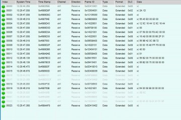

All the IDs that get send from the PSC3 on the left, the IDs from rectifier on the right side
When the controller has recognized the rectifier there are fewer messages nececary. Left PSC3 right side rectifier.
