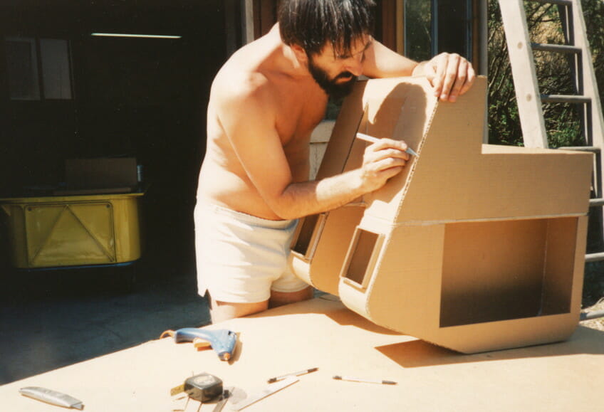

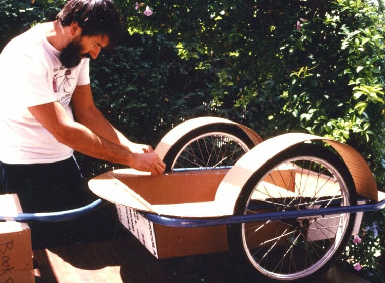

Another wood-based material worth investigating is paper honeycomb paneling.

AFAIK the internal structure in this case the foam and in the case of the trailer a page back the cardboard
is there more for 'shaping' of the overlaid carbon fiber and provides very little if any strength...
curves in the carbon fiber give the strength, a flat piece of carbon fiber v's flat piece with ripples
ruts or curves in it is much stronger IIRC?... The Nomex pictured above
