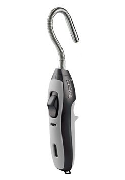

For shrinking down "heat shrink" insulation sleeves, my favorite is the "Bernzomatic" BZLTR300R, with a flex-neck. Normal butane lighters have a mild flame that always flows upwards, the Berzomatic (when set to max flow) pushes the flame out with enough force that it can flow downwards, which is very helpful.
Electric heat-guns are nice on your workbench, but this lighter is compact and portable, and it can even be used for soldering onto items that are fat enough that the mass would normally not allow a soldering iron to get it hot enough to melt the solder. This is because the flame tip is concentrated enough that the local heat rises faster than the heat can be wicked away my the thermal mass of the item.
There is a check-valved socket at the base to allow it to be refilled, and there is a clear window to show the butane fluid level.
