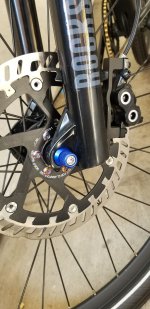

From brakes (Magura MT 5e's w/ MDR-P's) to fork (RS Judy Gold), to custom Bafang Julet wiring - extremely pimped out.

Tested (3-4miles each) today with 40%ish battery. Beasty-bike - 'Gumbo de Bodacious' - didn't like it much, but (finally) the ergonomics of the Archer Shifting paddle/ MT7 brake levers was perfect.
On a 60lb M620 powered, titanium rocket-ship. I don't need a throttle much, just be in the right (of 11) gears.
