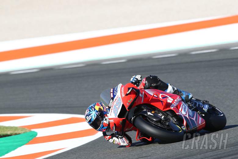

Motorcycle Road Racing went through this whole aerodynamic issue and arrived at a set of rules that seem to have calmed any anxiety about cross winds.
For decades the simple rule was "no fairing ahead of the front axle" and "no fairing beyond the end of the rear wheel".
That worked.
These days in MotoGP they are focused on down force and things like ride height adjustment to limit the tendency to wheelie which is not anything that ebikes or bicycles worry about. And in that they seem to have allowed some deviation, but it's still pretty much the same cross wind scenario despite all the winglets being added.
It would be great to have an UNLIMITED CLASS for human bicycle racing which had no limits on what you raced meaning that if a recumbent could win they would win.
The MotoGP companies have a lot of R&D money, so I wish they allowed fairings from an inch in front of yhe front tire to a foot behind the rear wheel to see what they come up with...
Note the winglets.
