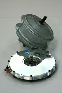

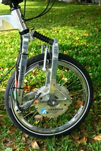

Taiwan`s ITRI Develops Super-Slim Rim Motor for E-bikes
Taipei, March 17, 2010 (CENS)--Featuring substantial weight and thickness reductions, the Industrial Technology Research Institute (ITRI) in Taiwan recently announced its successful development of a super-slim rim motor that can be used on ordinary and folding electric bicycles.
Lighter by 50% and 30% thinner, ITRI said that the newly developed rim motor is highly regarded by many bicycle makers in Taiwan.
Dr. Wu Tung-chuan, ITRI`s vice president and general director of Mechanical and Systems Research Laboratories (MSL) under ITRI, pointed out that the new rim motor is expected to be easily installed on most bikes, turning them into e-bicycles and helping local e-bike makers shorten product development period. Also consumers would have more options with the rim motor.
James Wang, deputy director general of MSL, said that the rim motor model adopts the innovative axial flux motor technique, making it owns a thinness of only one inch and weighs only two kg, but generating a two- to three-folds torque that generated by the same unit weight of traditional counterparts.
Wang added that ITRI is applying the patents for the rim motor, which can easily be installed on the side of front or rear wheel of a traditional bicycle, achieving the goals of simplifying e-bike production processes and adding new values to bike products.

At ITRI some 60 engineers are devoted to the development of new battery technologies. Their first major accomplishment is STOBA. This stands for Self-Terminated Oligomer with Branded Architecture. Simply put, it is a new polymer developed by ITRI that effectively prevents lithium batteries from exploding when damaged, as has occurred in several high-profile cases in recent years. Those incidents took place with laptop computers, where lithium batteries are commonly used. Nowadays, they’re also found in higher priced and better quality e-bikes. And with iPhones, iPads, and tablet computer sales soaring; all of which are all fitted with lithium batteries, it’s clear that the STOBA technology is very valuable.
Another major accomplishment by ITRI is the development of a super-slim hub motor. According to the research institute it is 50% lighter and 70% thinner. As well, the new motor produces two to three times the torque generated by traditional units of the same weight, with comparable production costs.
The new motor features Axial Variable flux technology. This technology is based on the principles of electro-magnetism and permanent magnetism, which not only contributes to the motor’s power but also to the motor speed control.
