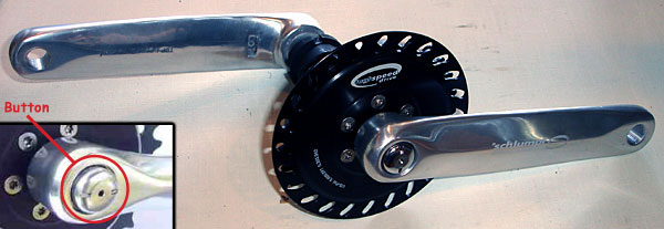

archer-ca said:Hey 1800vtx!
Cool choice on crank setup. I saw that Shlumpfh internal geared crankset a while back and thought it was absolutely insane!! Do let me know when you get it and how it works for you. I love how it works.![]()
Cheers,
