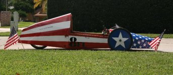

I spent the off season complettly redoing the car. Everything came off, rechecked all the welds and repaired. Lubed all up. Then since it was all apart it was time to upgrade the apperance. Out with coroplast and in with Alluminum, and a nice paint job.
