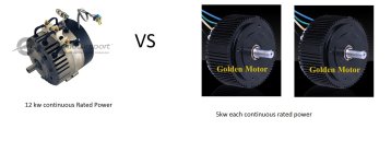

Hpm motor setup would run 100 - 200 amp each motor, x2 Controllers.
Mars Would run just one controller at full power, 200/400 amp
Same voltage and if i could make it the same gearing ect..
Based on that, Which setup would win in terms of speed, acceleration, efficiency?
Im not sure how well the hpms would run at 200 plus amps, But if it could take more than that, i could just run them at higher peak power to which i am fairly certain would beat the mars..
But I could end up with x2 burnt out hpms which would suck.

Coupling two of 'more' motors are the way to go with separate controllers so you dont have to deal with loads of current capability from just one controller ( works out a fair bit cheaper as well ). I have not done the common shaft option as this complicated things for my needs.

I setup a pitbike with just 1 6374 rc running at a 75A limit It was only geared for a top speed of around 22/25mph but it would out accelerate a 125cc (tuned) pitbike from the line up to around 18mph with ease and even though the top speed was only around 25mph it would hold its own on a short off road track against 125cc pitbikes, so if another motor was added the top speed could be geared for more like 40mph with the same ripping acceleration, just some food for thought.
I would love to try an rc motor build.. been thinking about that for a long time, but im more inclined to use one on a surfboard or canoe. to cold for that now tho
But for now i cannot decide either 1 or 2 motors. Has pros and cons for each
