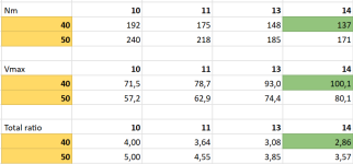

QS138 90H
Fardriver ND96680
Gear ratio 2,86:1 (14 front : 40 back)
26S8P Custom Molicel P42A battery pack
Sub 100kg race-ready

I worked out the gearing to be 100km/h without any field weakening and 137Nm of torque. I have a few other sprockets that I can choose from to get other gear ratios depending on need/track. Currently selected 14:40.
With ~250A @96VDC and say 10% losses I would be pumping in about 21,6kW in, and if possible to use the boost current of 330A that would be roughly 28,5kW. It would be comparable to a Rotax 125 kart-engine of ~24kW
