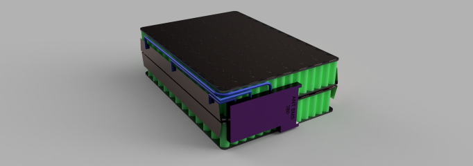

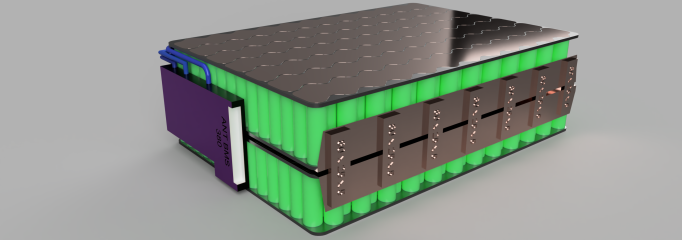

Layout: Above are a few renders of the layout I am planning. The 7 copper bars connecting the two packs together would most likely be mesh or something flexible so I could fold it over. I will also have an insulating barrier (squishy, hard, squishy) between the two halves and around the cells to protect them from rubbing/making contact with the busbars on the end of the packs. Is there any issue with the orientation of the busbars (2nd picture) for + and - to connect the BMS and Controller? I am concerned about arcing in that area.
Basics: I have designed a 28S24P battery that I would like to build. I designed it with the Molicel P42A 21700 in mind. It seems like a decent battery on paper and the price isn't too bad. They claim to have a 45A continuous discharge, but even being conservative and assuming I only get 35A would still net me 840A total. The nominal voltage would be 100.8v with a peak of 117.6v.
Connection: I believe .3mil copper nickel sheets would be sufficient, but I would appreciate input on this. I am also planning on using a kWeld to adhere the sheets to the cells. I haven't seen another welder that is able to do .3mil copper. If there is a cheaper option that won't be too frustrating, I'm open to suggestions.

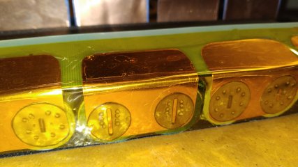

Are you intending to weld copper with no sandwich?
I have welded 0.3mm copper under 0.2mm nickel plated steel using welding flux at about 90% of the available power of my AwithZ P20B welder.
Welding 0.2mm copper under 0.1mm stainless steel requires about 55% of its power without using flux and 38.5% using flux.
Stainless steel is the magic sandwich copper welding aid.
You will be able to weld 0.3mm copper under 0.1mm stainless with ease using the P30C, without using the special welding flux. You might be able to weld 0.3mm copper without SS sandwich or flux, but likely at near its full power.

Once upon a time i figured the nickel on top of copper would not only be a welding aid, but help carry some current too.
I realized Nickel plated steel was a much better welding aid than pure nickel
The i realized stainless steel was a much better welding aid than nickel plated steel.
Then I stopped looking at the top sandwich layer as anything other than a welding aid.
I want as thick of copper as possible touching my cells.
0.3mm copper under 0.1mm stainless steel is up nearl the limits of my P20B welder.
I only use stainless to get copper welded to the cell.
I know some want to use nickel on top of copper to increase ampacity.
I would personally much rather use thicker copper under stainless and not even have the stainless bridge the parallel or series connections.
This is just a small 10s2P esk8 battery, and needs to be flexible, so the 2P series connections are dual 14awg silicone wire.
4 pairs of welds, even on the cathodem and 0.2mm copper, is likely excessive, but that is how I roll.
And I roll a lot.
Those 0.1mm slotted round stainless pieces, on top of the hand cut 0.2mm copper, were a gift from @ZEUS-FL
Shown as an example of stainless being ONLY a welding aid, which also strengthens the whole thing.
Calculate the cross sectional area, for ~700 800 amperes in this application 50-60mm^3 would be about the minimum off the top of my head.
I personally like the kweld, you would just need something that can dump ~1800 amps for a decent few milliseconds. Even if there are other welders that claim more power, I still prefer the kweld because of its consistency and you can actually see how much power you are pulsing and you get very fine grain control versus some obscure 'gear' or 'step' settings that many of the common chinese welders have. Though do note that you should probably upgrade both the welding and input leads to a higher gauge wire as the stock ones get very hot.

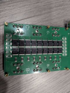

BMS: I am still somewhat confused on best practices for BMS. it seems like some people swear by active and others are passive only. I want to make sure my battery remains stable, but I don't want to waste money if there really isn't much benefit.
There isnt a right answer, it depends on what you want, the only real difference is that with a passive balancer it will take much longer to balance any large differences in cell voltage. This doesnt really matter if your cells are very well matched and balanced from the get go though...Personally I dont really bother with active as if anything actually gets to the point of needing more than a few hundred ma worth of current, somethings probably wrong with the pack and Ill be taking it apart anyways.

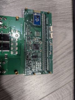

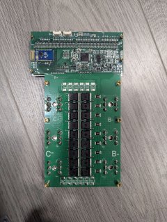

I was planning on using the ANT BMS 21S-30S 380 Amp with a peak of 950A. My conservative estimate parks my battery at 840A, but technically if I get the full discharge rate, the battery could hit 1080A. Is that an issue since the BMS wouldn't be dealing with discharge, so it would be charging at a designated rate under the 950A?
I have one of these, its pretty nice and the mosfet rating is very much in excess of the label. It has 42 of the HYG065N15NS1P/B in parallel for a total of about ~7ka but youre going to be limited by the pcb far before that. Here are some internal pics if anyones curious:
(may or may not have forgotten to take pics of the top side haha, but its pretty similar)https://www.lcsc.com/datasheet/C2687415.pdf

So I did a cross sectional analysis vertically down the length of one of my bus bars and the face has an area of 159.6mm^2. I don't totally understand how that fits into the example calculation above. If it were ^3 wouldn't that just be the volume of the whole bus bar?

I plan on measuring all the cells and pre-balancing them before assembling everything, along with grouping the most similar cells to keep everything as balanced as possible.
What do you mean that I would be limited by the pcb?
I completely misspoke haha, meant mm^2 which would be the cross sectional area rather than the volume. Apologies.
I didn't even know about the 'gear' or 'step' settings. Surprising, I know... Good to know about the fine control and updating the leads tho. I have a feeling I'd be heating the leads up pretty fast doing 600+ cells.
Yeah, kweld lets you set a particular joule amount and then alters the pulse time to get that power output. Its actually pretty neat.
Youd be fine with either then! Its up to you if you want to go with active or not.
The pcb is not able to carry that much current, just guesstimating based off thickness and potential fill I wouldnt really go over 2ka (I dont even remember if the software lets you set it that high...I dont believe so, bit of an irrelevant point haha...)
