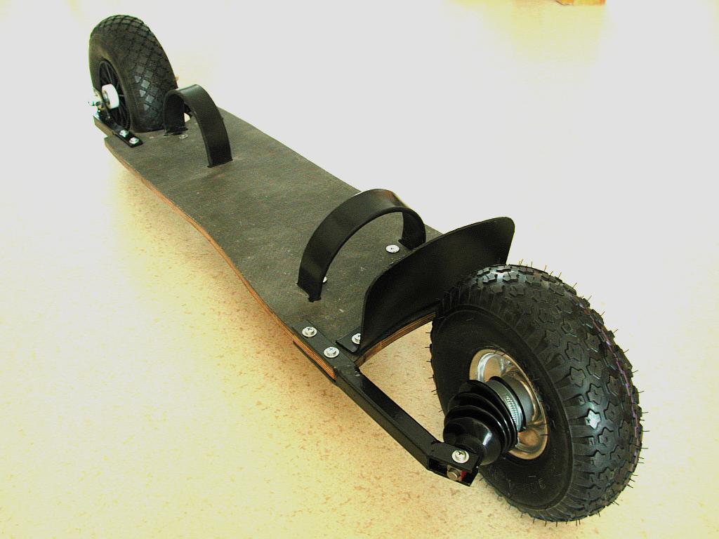

time for an update me thinks...
probably 10-15 minutes away from being ready to run... just need to stick down a few more components, namely the reciever and the on off switches + a few other dribs and drabs. progress has been slow due to ilness resulting in shitty exam marks, and a resultant sup exam this monday, which I've been craming for to make sure I can ace it even if I do get sick again....
The wireing actually looks neater in person, has a kind of vascular alien quality to it...
I cut a old freewheel body from a bike in half, and then machined some sleeves to adapt and lock them to the motor axles, using 2 grub screws about 120deg apart. This is the right hand one - I used a 20mm bolt as the base for the sleeve, which enabled me to then turn and tap a large 'nut' to clamp the sprocket on to the freewheel body. the other side uses the end of the freewheel body, so I could use the normal lock nut from a bike to secure the sprockets.

as requested
using 3 8mm bolts, tapped right into the truck hanger itself. seems to be holding up really well so far...
the 3 bolts on each end are to hold the angle alloy in place and allow for chain tension yo be adjusted.
