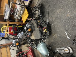

Hey all, I started a company that repurposes lithium batteries for stationary energy storage applications. Since many of the batteries we receive are from scooters and e-bikes, we’ve refurbished a few to go back into scooters and e-bikes for several employees. I recently found a cherry Lance Power Cali Classic with a blown GY6 engine. And while I have plenty of experience with ICE that meant it would’ve been cheap and easy to rebuild, that kind of goes against the grain of what we do. So we’re going to build a shop scooter for local events and pickup/deliveries.
Thankfully a lot of the prep work has been done by JimVonBaden in this Vespa build. That includes replacing the integrated cantilever swing arm and switching to hydraulic rear disc, which is our exact same scenario. Our plan is a 5kW QS hub motor and controller, which will leave plenty of room in the middle for battery. This is a cruiser so unsprung weight isn’t a high concern.
How we picked her up:
How she sits now

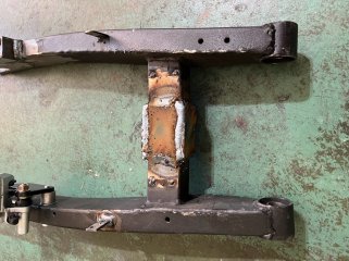

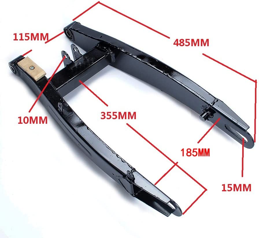

Should be a fun scooter. We've found a cheap swing arm that we'll strengthen a bit and add shock mounts. Dimensions appear to be what we need, will need to weld to the frame a cross member with mounting tab and modify the ends for pinch bolts.

Because the engine and gearbox also functioned as the swing arm, we had to find and modify our own to mount the hub motor. This took a few days of cutting and welding, cutting and welding once we found a swing arm that was close to what we needed on Amazon. We sourced a bolt and brass bushings from eBay, then welded in a crossmember to mount it to the frame. We also had to weld together flanges for pinch bolts to hold the hub motor/wheel in place.
The swing arm is an inch or two shorter than the GY6, which pushed the wheel into the plastic wheel well with the stock spring. Solution: add cheap aluminum spacers from Amazon to lift it 1-2”. While not ideal both aesthetically and performance-wise, it’s far cheaper and easier than adding a second spring.

And I would love to see some photos of the swingarm and mounting to the frame.
Will get some better photos of the swing arm. I need to pull it off, clean/grind it up and powdercoat, it's still bare metal. The swing arm was crazy misaligned as we received it and we had to modify the axle mounts. It also required a cross member welded to the frame. I ended up bolting it to the frame, cutting the swing arm's cross member and tack welding two L brackets to it after bolting on and straightening the wheel.

Good to clamp the motoraxle like that. Total battery capacity seems very good. A cover over the battery boxes painted black would be great.
Nice build! The custom swing arm looks good and the bike must be a bit of a sleeper, especially looking so clean. I'm using a similar motor on my Grom clone.
