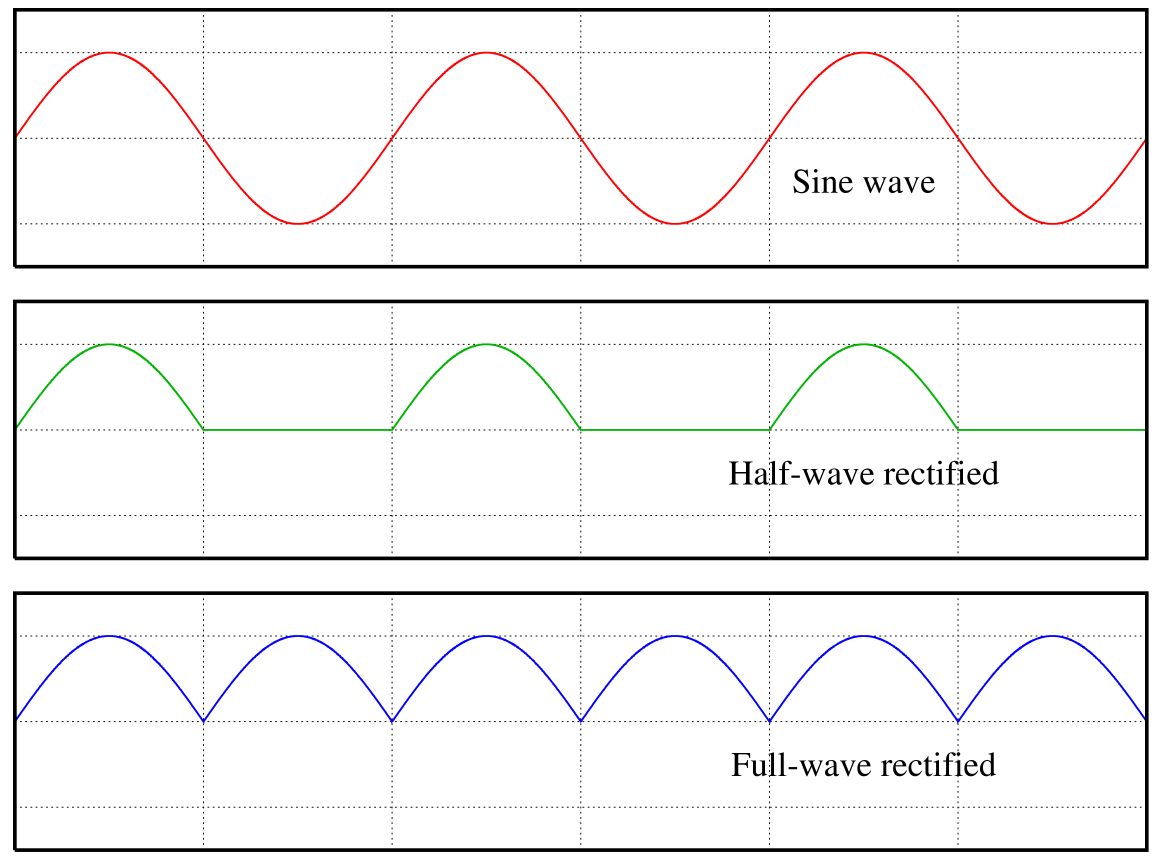

Is it 104volts? 165volts? (based on the peaks) I never got a good answer on that... :?
Well the AC voltage is 115v. Using a multimeter, I got a value of 105v out of the bridge diode. However, just because it is rectified doesn't make it really pure DC.
My multimeter was trying to measure the unsmoothed last graph, and came up with 105. A capacitor with no load will be charged up to that peak, at 165v. So, we're looking at getting a 165v out of an outlet.
So, I don't understand the relationship between charging voltage and battery voltage. If I plug a current-limited 165v power supply to my 105v discharged pack, what happens? It's a resistive load, and it's a 60v potential, so it will draw current according to Ohm's Law up to as much as the current limit will allow.
And all that voltage doesn't pose any problem to the battery? And in that setup where do you place the leads to monitor the battery voltage while charging (and not the supply voltage)?

I don't think the capacitors on the output side of the bridge do anything - the batteries act as a large capacitor. According to EV guru Lee Hart, the inductor goes in series with one of the AC input wires and the capacitor goes directly across the AC line, before the inductor. (I'm building a bad-boy for my pickup conversion and am facing the same issues - 120 VDC pack.)
:idea: Wow... that's a great realization.
Yeah, within limits I suspect you could just pass the unsmoothed voltage into the battery and the battery itself could smooth it out. In fact, if I remember correctly with SLA, it tends to prefer being "shaken" a little... at least on discharge. I'd be curious if all chemistries like this "shaking" going on. (somehow I suspect that some will not like it so much)
