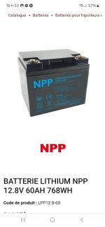

many years have passed, and tomorrow I plan on getting these lithium batteries... would this be a good or bad idea? I will change the charger as well. anyone know if I can bypass the governor on the original controller?Lithium battery.jpgScreenshot_20250503_145830_Chrome.jpg

Is 60 amps enough for your scooter?
You haven't taken the time to tell us what you have now. There is a picture of the controller - thanks - and that does say 128W max. That doesn't decide what your scooter uses.
Posting good pictures of the previous battery with the labels showing clearly would permit investigation about what was adequate before.

I tried 4x40Ah LiFe in my EVT 168. I didn't do my homework. The batts I got only had max, or burst current of 80A for up to 10 seconds. More than that when accelerating hard & I was on an E scoot without any E until the BMS reset.
Your spec sheet shows 160A max, hopefully that's enough.
