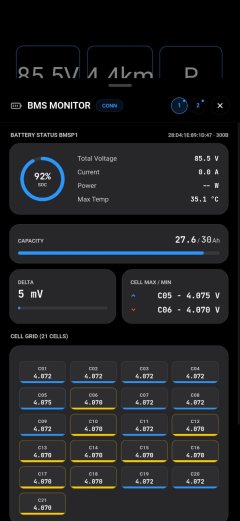

And i wonder if you can sniff the jikong bms too.. i tried and it works. But in other valur its in correct.. i attach some picture my attempt to connect to jk bms.
