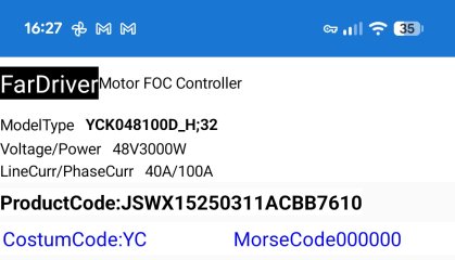

Hi, I have a question: how do I choose the right firmware, and which version of the software on the phone should I use to flash it?
Upon initial connection, the controller was not a pirated unit.
You've go a OEM Version, so only the manufacturer can tell you which is the one you need, and Fardriver won't answer. 😉
1. So I can just keep riding like this and wait for a fix to come out. 2. Try flashing it blindly and end up bricking the controller. 3. Just throw it away and buy another one.
So, thank you for replying.
