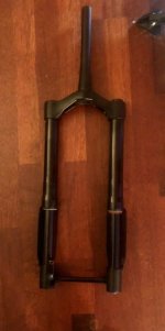

Front suspension i desided on trying the upside down design as DNM US6 15x150mm thru axl.
I struggled to find a suspension fork with 15x150mm for strait frame tube, only tapperd fork was availble for fatbike. Solution was a semi integretad head bearing.
The head bearing set is in place.
Trying on the front wheel, think it’s looks good :)AB6F55C9-57B6-443F-9A24-01FA1D8AB1E2.jpeg
