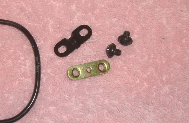

A tapered reamer eases the re-installation
, and then the centering and the squaring-up of the two mounting "U" bars,
which are length-adjustable.
The included hardware is "sort of OK", but you can do better with bolts that actually fit the threaded
holes, if any, in your bike's dropouts, instead of using the supplied, small-diameter bolts with nuts.
Do it as you like.
Dull black fenders look very clean and quite "guy" like.

Yet, every fender will need a little "make do".
CLICK
if you like a bigger image?
:? That fat tire, the narrow fork crown, plus the too-tall, silver bracket:
See the Edison quote? So true.
Must cut the bracket in order to raise the fender fully into the crown away from the tire,
to avoid excess-ugly, useless spare height, of the fender's front bracket.
The cut is "rough" and will key into the paint.
Then fit the stay bar, using the cheapo-bolts for now until I get Trek-threaded-whatever size those holes are,
socket button-head screws would be nice
Will paint the silver with Model T Ford "motor slush" black and apply a dab of clear "Polyseamseal" PVC caulk, not silicone crap, behind the bracket,
to seal the bolt hole against water intrusion and ensure against vibe-induced creep, ever. The "burr" of the cut also helps ensure that the setting holds firm.
