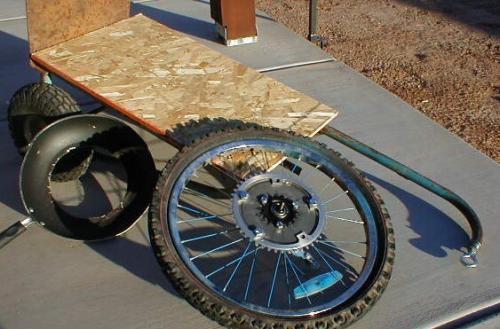

GGoodrum said:All I have left to do is fashion a tensioner pulley for the motor-jackshaft chain, and reverse one of the phases on the Cyclone motor.
-- Gary
I'm don't agree with those advantages though. Matt posted that cheap FW's are fine. He uses one on his 8kw recumbent and hasn't had any problems. Someone asked him why they fail on Cyclone's and he said its the weight of the rider pedaling. If thats correct the cheap FW won't last very long. Also Sickbikes sells the cheap FW's for about $20 and the White for about $65 so the price difference isn't a big deal. I think its worth paying the additional $45 for a sealed FW vs one with recommended periodic cleaning and lubrication.GGoodrum said:Here's what I did:
I have a jackshaft that is mounted right behind the seat post, between the chain and seat stays, that drives the 34T sprocket with a 12T track cog. The other end of the jackshaft has an ENO FW attached to a 55T #25 chain sprocket, which in turn is driven from 24T #25 sprocket on the Cyclone motor. I'm using the standard Cyclone crank, but with just the 44T chainring. There are two big advantages of this approach, over the motor driving the front crank. One is that since the power is not having to go through the crank anymore, you can get away with the cheap FW up front. The second big plus is that you get the pedals back.Going through the crank, you just about lose all use of the pedals in most higher power/higher speed setups.
GGoodrum said:Anyway, I will start a new thread on this in the next day, or so, once I get it finished. All I have left to do is fashion a tensioner pulley for the motor-jackshaft chain, and reverse one of the phases on the Cyclone motor.
-- Gary

MitchJi said:Both serial and this dual right side sprocket (DRSS) approach separate the Chainring-BB from the drive line. Serial has two big advantages:
1. Chains are not back-driven (quieter and more elegant).
2. No FW required on the crank.
IMO the DRSS approach has two big advantages:
1. A full stage of reduction. This means you can get about the same reduction with a DRSS using a one-stage reduction drive as the other options using a two-stage reduction drive. I think there are 3 options for a drive using the gears in a geared hub (if there are more I'm pretty sure Miles will let me know). Crank drive, serial drive and DRSS. Using (for example) a 48t Chainring with a 16t rear sprocket:
Crank-Drive: drive 16t and 48t on the BB they cancel out. You can tweak the sprocket sizes to get some reduction but not very much if you want it to work well with pedals.Serial-Drive: 16t drive output to 16t rear sprocket. Once again you can tweak the sprocket sizes to get some reduction but not very much if you want it to work well with pedals.
DRSS-Drive: you can pretty easily use 16t to about 48t (if it fits). Even more with #35 or #25 chain.
Maybe you meant you get the pedals back with a single stage reduction drive?
MitchJi said:2. Also as compared to a Serial-Drive in addition to being more compact due to the elimination of the second stage if you want to mount it near the chain-stay between the Chain-ring and rear sprocket it requires less space for another reason. With a Serial-Drive the closest the drive sprocket shaft can be to the Chain-ring is the radius of the Chain-ring plus the radius of the sprocket plus the distance required for chain wrap. This requires about 6"to 8" between the BB and the rear tire. With a DRSS-Drive the drive sprocket could be next to (alongside) the Chain-ring which means it can fit with a much smaller distance between the BB and rear tire. Might even be able to squeeze it in on something like D's Kona.
If they weren't so expensive and if the ratios work well and if it works with FW cranks a a Schlumpf or similar 2 speed BB might be a great combination with a 3-speed geared hub. 3 speeds for the motor and pedaling plus a BB overdrive for high speed pedaling.
