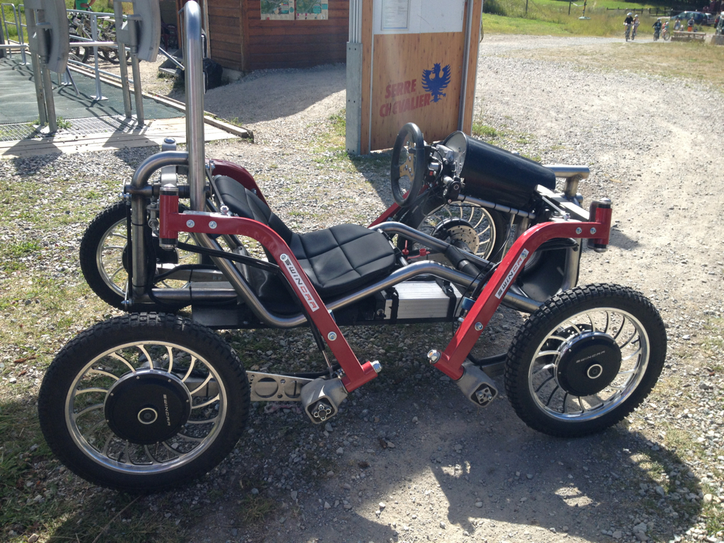

On another note neither Willow's nor Yamaha's trike are free to caster.
Neither EV4 nor Swincar are Free to Caster. Both have a control which links lean angle and the direction of the wheel. Free to Caster vehicles don't have this connection.
The Swincar moves its centre of gravity toward the outside wheels which means a greater likelihood of overturning than if the seat was fixed in the chassis. Yes it keeps the driver upright but there's a cost to that. It needs a wide track to keep the c of g in a sensible place.

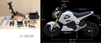

My leaning trike front end kit production soon
