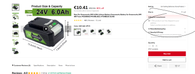

I need two more batteries from Greenworks . I am from Montenegro (small country in europe) and i need it for my string trimmer.
Now shipping is soo expensive and hard to get. So i was think if can do this. This is cheapest i can find.
But this : LINK and this link 2 , and find some electirician to put it together. My question is, are this possible and secure?

The greenworks battery case you linked needs 12 cells. 2 parallel rows of 6 cells. If you use the Samsung 25R cells you will get 5Ah, if you choose the red Sanyo cells you will just barely get 4Ah.
Another option is to just buy 24v batteries with cells in them. https://a.aliexpress.com/_EG4aYyK
These could last a year or two. I had a greenworks 40v battery from AliExpress that lasted me 2 years. The way it died was from corrosion, if I had known that I would have sprayed some clear varnish or used some nail polish.
And if the battery does die after some time then you can just replace the cells with brand name ones. This is the most economical solution in my opinion.

Don’t trust any cells where the seller doesn’t know what they are selling. They are describing them as lithium polymer (lipos) in their description.
For about a 10€ difference you'd be stupid not to buy those and just run them till they die. You can always replace the cells afterwards.

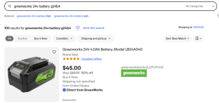

I try ebay, only option is this, but its pricey because of shipping, and plus taxes, it will be about 150usd. Which is extremely big price for just 1 battery. ebay.PNG
I tried everything, thats the reason why i ask here about alternative ways. There is a lot of shipping forwarders, but price is about 50usd for shipping plus taxes plus battery omg.
Is this the same battery

I said nothing about original, like I said before, buying just the cases is almost as expensive as the batteries with cells in them.
