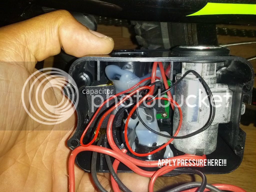

The capacitor is tucked away in the top of the battery case lid next to the ignition, I'm presuming its a capacitor as I can't get it out but it is cylindrical in shape. one of those wires runs to the neg coming off the BMS and the other is going to the positive off the BMS even though they are both black wires.

I'll take another pic with some light shining on the capacitor area in the lid
Eureka!! :D
If I apply pressure to the area marked in the pic (one of the connections from the ignigtion must be loose) then I get 41.7v through to the bikes controller and the bike seems to work! (havn't tested fully)
I stumbled upon this whilst checking various voltages of wires coming from the bms a moment ago.
Just wanted to say thanks for all the help in these forums..
Turns out the problem wasn't the Controller or the BMS, it was the ignition.
I desoldered the wiring for the ignition and cleaned it up and then re-soldered the wires and the fault still seems to happen but its the actual switch inside the ignition.
If I turn it to the ON position and don't firmly apply pressure as if i'm trying to snap the key then the switch doesn't work.
So I guess I'll have to remember to force the key every time I use the bike.
That's good news that it's something so straightforward, good bit of detective work in finding it!
You may be able to find a replacement switch that would fit, as often they are a fairly standard size. Alternatively, if you can take the switch out, then you may find that you can tighten up the crimped-in plate at the back. Sometimes these switches are poorly assembled and from your description of pressure fixing it it sounds as if the rear plate may not be fully home.
