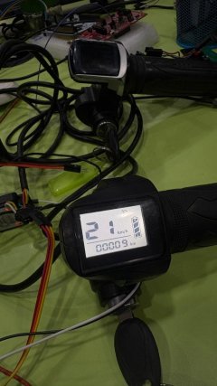

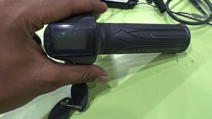

Hi everyone,
I’m currently trying to debug the communication protocol for a Chinese-made e-bike LCD display integrated with a throttle. This display seems to work only with its original controller, but I’m building a custom controller for my e-bike and want to interface this display with it — mainly to show speed and error codes.
I’ve tried analyzing the data frames using a logic analyzer at different baud rates and data bit settings, but so far, I haven’t been able to extract or interpret the correct data format.
Has anyone worked with this type of display before?
  • Any details on the communication protocol or data format would be very helpful.
  • If anyone has a datasheet or documentation for this LCD throttle, please share it.
Throttle Description (6-pin connector):
  • White – Key
  • Yellow – Key
  • Blue – Speed data wire
  • Black – Ground (GND)
  • Green – Throttle signal
  • Red – +5V supply
Any guidance or insights would be greatly appreciated!
Thanks,
Akshay
Maybe this is not UART but SIF?
As Arduino does almost anything by bit banging, I wonder if someone has written a SIF library for Arduino already.
Are you sure there is a communication protocol at all ? Looks to me like a simple analog display. Only concern would be to figure out the speed signal, but usually it's quite simple: some sort of pwm (on/off) and an inbuilt multiplier depending on numbers of magnets and wheel diameter.
