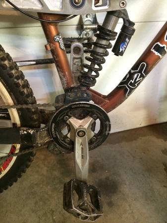

My first issue is motor mounting. For now, I'll be using my moded yescom motor... eventually I'll push into the world of middrive / the the cash isn't there and this yesmotor is. The actual dropout slot is a bolt on piece to the swingarm, that's pretty cool. I'm wondering if the piece is made of steel or something more handsome than aluminum. I need to research to confirm my suspicions. Either way problem is... it's not very deep. The line on the chopstick indicates the total height of the axle nut.
Here's a picture of the non-drive side. This side is interesting because there's another arm that bolts from the frame to the disk brake adapter. Issue here is finding a toque arm that will work well.
Here's a picture of the non-drive side with the brake adapter that connects to the frame pulled out from the slot. I'll have to unbolt these every time I take the motor off...
I'm sure I could file into the slots a little bit, but I don't want to modify them too much - there's not a lot of room to file into the slots and my track record with filing down dropouts is 0 for 1. This would be much different though, since I have the benefit of unbolting the dropout slot piece completely and fitting it on the axle nut. I don't wanna go too ham on it though since a mid drive motor is probably the plan for next winter. Can you guys make any comment on the dropouts, their efficacy in an unmoded state, any recommended toque arms or parts to secure the motor? If the slots are steel and the motors bolted on nice and tight, still yes on the torque arms? 4-5kW motor.

Lotsa meat there to file that dropout deeper.
But since it's a bolt on dropout, it's just begging for a set of custom steel dropouts, ones that are nice and thick with deep slots, so you don't even need a torque arm.

dogman dan! Thanks so much for your assessment of the dropouts. I did read that they're intended for 12mm axles... so about 2mm in should give me the proper space. My understanding is that the axle nut wishes to rotate in a counter clockwise motion, so making sure the bottom of the axle has dropout coverage will be important. Lucky I can just take them off and test-fit to my hearts content and that they are also replaceable.
You're totally spot on with suggesting the wider, steel replacement bolt on dropout. I think I would contact teslanav and grab a MXUS and see if Farfle could mix up some sort of replacement bolt on dropout or just a complete swingarm. It's definitely on my radar for the future.

The drop out that you have is a D.O.P.E. drop out for the floating rear brake. Floaters are good for competition and all but If I were you, I would just get a regular drop out for the brake side and use a torque arm.
http://www.hibike.com/shop/product/...9652a5/KONA-D-O-P-E-dropout.html#var_13389508
The site says they should be available in about a week and they are around 18 euros plus shipping.
Or you could make steel dropouts for it.

Odds are that it's aluminum.
You can confirm it by placing a magnet on it and checking weather it sticks.
