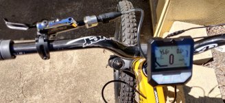

Now all that was missing to cap off the list of components was a suitable controller. Enter Nucular with their awesome 12 fet controller. This controller really does it all and supports all the tuning features I wanted and more. Regen couple with active braking gave me the opportunity to try out something I'd seen Ripperton implement with his Yamaha R1 race bike years ago, a pressure tranducer coupled to brake master cylinder.
https://endless-sphere.com/forums/v...=2&t=63341&p=947733&hilit=regen+bleed#p947733
![Shimano MC Pressure transducer Nucular .jpg Shimano MC Pressure transducer Nucular .jpg](https://endless-sphere.com/sphere/data/attachments/155/155248-7635eec1323c85f98739b0878c396814.jpg)
I'm still amazed how well this just works. The modulation of the brake force through the Nuc is super smooth and quite strong all the way down to a stop. It doesn't have brake locking power, just smooth strong deceleration. Of course I'll still have the back up of a full friction brake on the front wheel.
