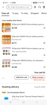

As for caps, i think you are buying from lucys quality store on aliexpress? It is the one i am buing from. I messeged seller about the caps and he informed it is nickel plated steel..i recieved another sizes and shapes from seller so i get higher caps and smaller diameter to get cap welded far from battery positive sealer ring.
