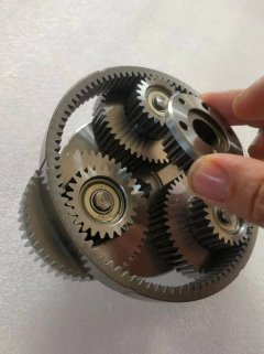

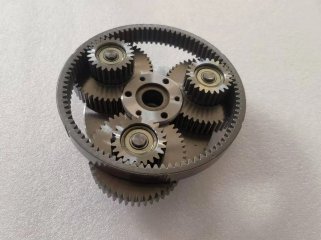

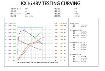

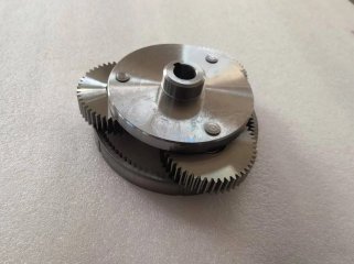

New here and maybe not of much help, but I've been looking at high-torque options for a garden tractor/utility platform. UUmotor has a new option that looks pretty good (for my purposes) here: 2025 new 1:10 high gear ratio 200N.m 16 inch tractor tire hub motor . 120RPM, 200Nm, and in 'tractor wheel' form factor they claim up to 500kg of load bearing capacity. They also have a variant without the integrated wheel - just a 4x100mm hub and a single-sided 25mm support (250-350kg load capacity for the single-sided version).
Maybe not viable for you though, since it's unlikely to be sealed.
I'm also getting the impression that uumotor isn't a particularly respected brand, although I don't know how they compare to other manufacturers. They *do* provide full performance curves rather than just marketing numbers, but I have no idea how reliable they are.
I'd been heading down the path of using a BLDC driving one or two garden tractor transaxles (peerless 820), but the 'engineering' to get both the torque I'm looking for and load-bearing capacity per axle is proving to be a bit messy. Just going with 4 of the uumotor units would potentially be a sacrifice on torque output (which realistically I may not be able to use anyway), but would dramatically simplify the build.
Looks potentially interesting, but they're still using the terrible-idea flatted axle for torque transfer, when there are well-tested better ways to do this nowadays. They wouldn't even have to engineer anything, just copy one of the known-working integrated torque arm types. :lol:
High torque setups especially used in a high load / stress usage really should be using a "normal" axle that is under far less stress, and not transferring torque thru flats into the part of the frame that's meant to hold up the vehcile from the motor, but rather to some dedicated part of the frame that can easily handle that torque, using an integrated arm that transfers from some larger diameter portion of the motor axle (like the Grin All Axle, or the GMAC, the Heinzmann, etc).

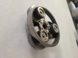

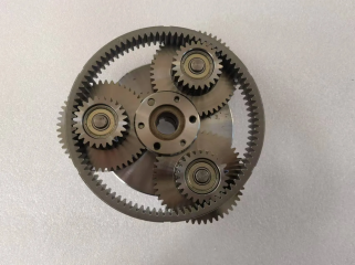

The "gearbox" double planetary reduction seems interesting, not sure how well it works but gives me an idea I will have to let percolate within my brain (about using two planetarys in series from two different hubmotors as a reduction for a different motor). I've attached images of the planetary setup and other stuff off that uumotor page below, for reference.

Fair point on the axle - it does seem a bit undersized for something that is targeted at a reasonably heavy-duty application. At least it's double-sided, I guess.
But - the planetary gear is interesting. I looked into various gear reduction strategies as alternatives to a full transaxle, and they all seem to be rather expensive for anything that can handle any reasonable torque. Getting a decent looking 10:1 planetary reducer and a motor and a hub/wheel for the price is pretty remarkable considering that a standalone reducer seems to run close to that much.
