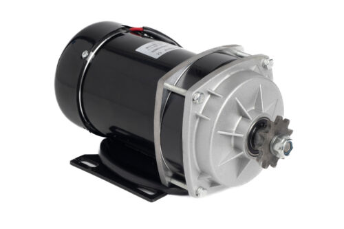

We are a jet sprint boat race team and we need a solution for a caddy or cart that we can attach to a 1500lb tool box. The caddy/cart would need to climb a steep grade up a ramp on a toy hauler. I would assume the grade is somewhere in the 25-30 degree angle and about 8-10' long. I contacted bikes.ca and asked about using two of the following kits. Barebones Electric Wheelbarrow Conversion Kit . They seemed to think it was nowhere strong enough to drive the cart up the ramp. Are there any hub motors with closer to a 60:1 ratio or do you have any other ideas? The caddy's top speed would only need to be about walking speed or even less. I was going to build the cart out of heavy steel but I need a drive system first. The unit will need to use a probably somewhat wide 10-15" (tall) tire so it doesn't sink in the grass which is where we pit for the races. I attached a pic of the boat we race in case anyone here is into that sort of thing. Thanks ya'll!

Even reasonably sized dual hub motors ( RH212 ) on 12" wheels will melt in a 2-3 minutes on a 15% grade if that's what the grade angle converts to.
Your best bet is a stationary motor ( 3kw rated ) with a sprocket and an extremely massive reduction ratio.

My first thought was a winch - either mounted in the trailer, or on the tool chest with a robust anchor secured on the trailer floor - assuming the tool chest has wheels?
You need one of these! Thing is a beast on 24v. Go with the 48v version and it will pull it with ease. I was also going for the smallest footprint possible. If you went with 3 or 4 wheels it would be even better. *After having traction issues in soft sand I upgraded to more aggressive ATV tires from sunf as you can see in the video.
This 36v 800w motor + 10T sprocket would be plenty for 1500lb. If not go with two of them.
I like having the axle and sprockets so I can change the gearing/speed as needed. But this would also work if size and weight is not an issue:

Late to the party, but pushing 1500 lbs up a 30° slope is like lifting 750 lbs (sine of 30° is 0.5), so you need 750 lbs * 0.453 kg/lbs * 9.8 N/kg = 3,300 N tractive effort. With a 10" diameter wheel that's 420 Nm of torque. So a 60 Nm motor would need an additional 1:7 reduction, better a bit more.
