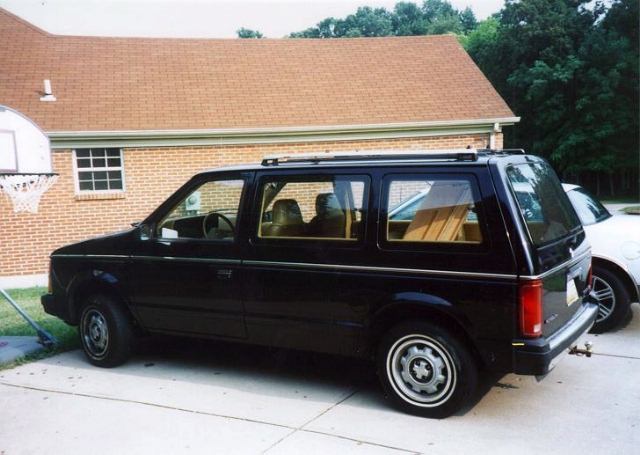

The Caravan might be good!
Not too slippery, but light for a van and lighter still if you gut all the insulation and creature comforts. Finding lighter bench seats would also be a plus.
Motors like cold, batteries hate it.
Also, there were a bazillion of them made - lots of parts. I did a quick check and it seems it is easy to upgrade the suspension with a towing package to be able to hold more batteries :)

Well, if you are willing to eliminate some top speed, and settle for something that can hit 55 max, then you don't need that 98 HP of the carivan. A manual transmission is good for about 85% of the engine power, but an automatic, Like the Ford C6 is lucky if it can deliver 60%, so depending on the Carivan's transmission (Chrysler Front wheel drive Autos are natoriously bad) you probaly only had 60-70 HP anyway.
You can cut that number in half, as I'm beting you won't need to haul a wife and 6 kids plus a weeks worth of luggage at freeway speeds, so 30-35 HP at the wheels should run it on gas, and since Electric makes max torque at zero RPM instead of at peak, you could almost cut that number in half again for electric. Lets call it 20 HP. Thats 15Kilowatts by my rough figures, but most builders on that Austin site seem to favor 20KW motors. probably because they run through transmissions at a 15 to 20% loss. All rough figures, but my numbers seem to be coming up with what others have done.
RVs use a propane heater that runs on a heat exchanger. should be easy enough to modify one to fit in the engine bay of a caravan.
and IIRC, the caravan has a nice flat floor from behind the driver seat all the way back, so adding batteries sould be easy.

When I replaced my tranny in my 1990 Plymouth voyager a few months ago my gear head friend who did most of it was tempting me with putting in a 5-speed manual. (it was just rusting in his garage. From another car, but he said it'd fit just fine) I'm pretty sure the 4-cylinder versions had manuals available. Also, I think a mini-van like mine would be an ideal conversion. With the fuel tank and exhaust gone it'd have a 10inch thick space 36in wide and about 72in long stretching from the front to rear axle with only a few ~3in tall floor beams to miss. Could fit one heck of a battery in that space. Aerodynamics are pretty bad on these old crates so getting good range is more expensive, the massive cargo space makes up for it some. Too bad my car is half rust by weight.
Anywho, manual tranny mini-vans DO exist but are rare.
Marty
I just know I hadn't owned or seen a stick in a minivan, and I've had a couple plymoth vans. One thing I learned reading all the car conversion blogs was that a lot of conversions suffer from poor donor vehicle choice. Extra metal is an anchor to carry around especially if the car is to run on lead batteries. People get stuck on the idea of a free donor vehicle when that is 5 or 10% of the cost of the project. Then they need an extra $2000 for enough batteries to haul the heavy, unsuitable car around. I saw one blog where a guy wanted to convert his F250 4wd truck. To get a 5 mile range he's gonna need enough batteries to take 5 geo metros that far. Put a load in the bed, and he won't make it around the block. The volkswagon conversions are soooo much less work to convert, and in the west they are still around to buy cheap. If Pengyou really needs the van space, fine, but the free electric car donor is often very expensive, especially if it does not fit needs. The number one need of EV's is to be lightweight. The minivans are light for vans, but still pretty heavy. I know, I've owned three of em, four if you count the VW.
