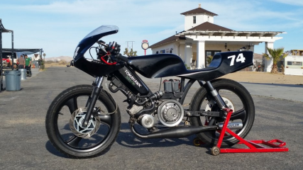

Or you could go for an underbone style 49cc moped as a donor. It would weigh more but probably cost quite a bit less, and be right in its element at 40 mph. Deleting the motor and transmission would afford you some kind of battery bay.
I always liked what this guy did with underbone (i.e. step thru chassis) mopeds:

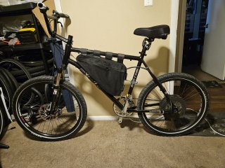

Here's my 30mph bike, soon to do 35mph. 24" rear so i can extract more power out of a smaller hub; a nice suspension seatpost and fattish tires is mandatory on a hardtail at that speed.
Range at ~31mph is 30-35 miles. Can charge to full in 4 hours.
Sound like your kind of build? a dual suspension bike would be nicer but they are challenging to fit a lot of range in.
