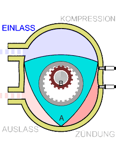

Wankelmotor:
-Solves the problem of early inflammation because of
->no contact with hot gases left inside
->no hot valves
