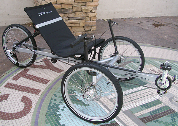

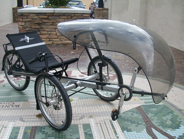

some rover mods from Utah trikes ...
They say an elec assist is coming ... I suppose one could do a non hub motor with internal gear rear hub or a hub motor with freewheel ??
http://www.utahtrikes.com/RECENTTRIKE-superrover.html
http://www.utahtrikes.com/RECENTTRIKE-TerraTrike_Rover_8DL.html
this would take the hub motor with freewheel ...
or for more cargo ....
