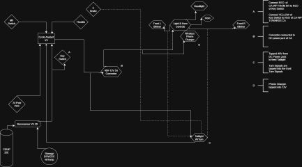

UPDATE: Long overdue, here is a wiring diagram that I made for my bike in it's current state. This is my first attempt at creating a wiring diagram so feedback is welcome. I'm using drawio.
The lights have this harness and it is fed 12V from the DC converter AFTER the Wireless Charger connection.
This is all very straight forward for the lighting. Plug 6 (for brake sensors) is connected to the CA, as opposed to the "controller brake plug".
A few things regarding the lights.
I use this to control turn signal, headlight, and horn.
The wiring key was a bit lacking. This is how I’ve wired this control to my light kit that I linked above.
The White, Orange, and Red are all connected to the same 12v coming from the DC converter.
