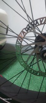

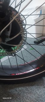

Pictures save a lot of words
The front looks rotor/caliper pad alignment reasonable to me, not knowing the width of the pad compared to the corresponding rotor sweep area. Not so on the back, where my first guess would be the caliper is spaced too high (edit: too far out radially). I use a bright flashlight when setting up the disc caliper height.
The front looks rotor/caliper pad alignment reasonable to me, not knowing the width of the pad compared to the corresponding rotor sweep area. Not so on the back, where my first guess would be the caliper is spaced too high. I use a bright flashlight when setting up the disc caliper height.
I guessed "aluminum frame" based on this picture you posted elsewhere (speaking of pictures), based on the top/down tube welds along with the rectangular chain stays:
Good eye. When mine were off, the brakes would work until one day the suddenly wouldn’t. The pad to pad contact (green and blue arrows) prevented any braking, unlike normal wear where you still have something if you squeeze hard.
shoes-jpg.325206
The yellow arrows are where there was metal to metal contact with the rotar when the pistons continued to squeeze the pads at an angle.

Your rear caliper is to high maybe when you switch to 203 mm rotors it will line up better.

After a thorough evaluation of the rear brake installation, I determined that the rear adapter for the caliper was reversed. This occured a year ago when a shop (no need to mention names) converted my mechanical brakes to hydrolic, and installed the bolt on adapter incorrectly. Another expensive lesson learned and another payment paid for my education. I will change the rotor and the pads myself. Going to a 203 on the front and staying with 180 on the rear.
