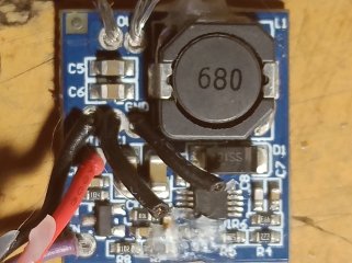

7️⃣ “Mystery Board” (MB) Identification​
Previously unknown board identified as:
High-voltage buck converter module
MB Components:​
  • Inductor “680” → ~68 µH
  • Schottky diode SS16
  • 8-pin buck regulator IC
  • Pads labeled:
    • VIN (battery input)
    • VOUT (low-voltage output)
    • EN (enable)
➡ MB is responsible for generating logic / lighting supply rail.
8️⃣ Critical MB Wiring State (Root Cause Emerging)​
  • MB VIN wire was disconnected
  • Therefore:
    • VIN = 0 V
    • VOUT = 0 V
    • EN = 0 V
➡ MB was never powering up.
After reconnecting VIN:
NodeVoltage
VIN~52 V
VOUT~0–150 mV
EN0 V initially
➡ Buck still not starting.
9️⃣ EN Pin Investigation (Smoking Gun)​
Diode-mode comparisons:​
Original MB (installed):​
  • EN → GND ≈ 1.17 V
  • EN → VIN ≈ 1.9 V
  • EN → VIN resistance ≈ 60 kΩ
Spare MB (disconnected):​
  • EN → GND ≈ 1.65 V
  • EN → VIN ≈ OL
  • EN → VIN resistance ≈ 10 MΩ
➡ Original MB shows abnormal leakage / pull-down on EN when connected to controller
🔥 Live Behavior (Very Important)​
With controller + display powered:
  • EN → GND ≈ 1.7 V
  • EN suddenly jumps to ~52 Vwhen:
    • Display backlight is enabled
  • Rear red light still does not turn on
  • VOUT remains ≈ 0.15 V
➡ EN line is being back-fed / incorrectly driven
➡ MB never enters regulation mode
➡ Logic/light rail never comes up

P.S. MB reffers to small (i think AUXiliary) PCB with - 3 GND wires (2 for lights GND and 1 GND going to controller), 3 RED {VDC?} wires (2 for lights and 1 CURRENTLY DISCONNECTED {and at the begining point}) and 1 PURPLE wire marked on PCB "EN".
Pic 1 - "MB"

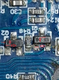

Pic 2 - 1/2 PCB Face

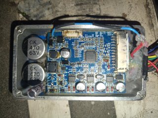

Pic 3 - DisplayThrottle PCB

3A 1A 53 02 19 08 90 00 0D 0A
This is the 5s protocol often used by Lishui controllers. There is a known issue with weak level shifting transistors of the controllers TX line on the PCB. So the display gets no answer from the controller, shows E30 and stops sending UART messages after a while.
See this post:
See this post:
Thank you very much buddy! That was really fast and usefull.
UPDATE: Pic with duo measurments. Could someone interpret those please ? Ill now take measurments on my dead controller secondary PCB, but bare in mind that i already desoldered the duo transistors so ill be measuring the empty trans. solder pads (maybe usefull idk ? :eek: ) (Measurments in Diode mode and unpowered ofc)
P.S. The readings look okay to me until the point where i get 1.4V in reverse on the left trans. but then again looking more deeply i see they are VERY weirdly (to me) connected so i donno what to think of that measurment?
P.S.2 The tiny resistor between the duo measures 20k Ohms, just to clarify.
