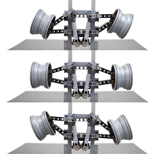

Well this steers by moving the Tadpole suspension arms and is well suited to the ... side lever (whats it called?) type steering usually used.
I also note the the outside wheel moves back, which may well help stability in turns as it moves closer to one's center of mass... if you get my meaning.
Steering should also be a lot less twitchy... as no one has yet thought of using elliptical gears/sprockets to solve this issue in conventional systems.
http://sariel.pl/2015/03/virtual-pivot-steering-system/
