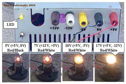

Stumbled across one of these devices while walking around Maker Faire with Fechter last weekend..
..and it got me thinking, "I have a couple of these power supplies -pulled from otherwise dead computers- just sitting in my garage.. hmmm."
Anyway, I found a cool 'How To' @ http://www.wikihow.com/Convert-a-Computer-ATX-Power-Supply-to-a-Lab-Power-Supply ..thought other spherites might find this useful.
