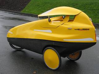

Ok, so I have an idea that just occurred to me when seeing someone else's pursuit of a design in which to build a leaning delta trike.
The biggest objection I have for most delta style trikes, is they either have one rear wheel powering them, or the front wheel, neither are ideal.
I have come upon a solution in my mind to this issue, and I want to brain storm with you all, please feel free to poke holes in my plan.
To avoid the problem of one rear wheel powering the vehicle, and an overly complex rear differential like you have in a car, I propose 2 rear hub motors in 20" wheels in a similar style leaning mechanism to this Varna bicycle:
(Video download second from top)
http://www.varnahandcycles.com/video.htm#hc16
The pros are pretty obvious to me, simple construction, uses a snowmobile style torsion bar in the middle "boom" section so that the front half of the bicycle leans letting the rear wheels stay in contact with the ground.
Cons? Perhaps in my incarnation the extra weight and known disadvantages of hub motors in general, however, I would propose to use two of John in CR's scooter hub motor's in 20" mag wheels (scooter/motorcycle wheels that will bolt to the flanges of the motors as they are designed) thus eliminating some of the potential down sides of heavier hub motors when using bicycle wheels & spokes (sure this will weigh more, but no issues with spoke maintenance and limitless cargo capacity compared to bicycle components).
I would have my design perhaps a little lower to the ground, more in-line with the height of my Vision R-40's seat hight, so it will be a bit lower than the design of the Varna that seems to be build more with ease of riding and use than aerodynamics.
This would allow for a higher seat position and less compromise needed to get much the same aero advantages when covered with a Velomobile shell with out the lower seat that you have to slip into, instead it can be a flip-up style monocoque shell much like the popular Lietra Velos:
And I would design the shell closer to the style of this other leaning trike, but with a roof with maximum visibility and maybe a very narrow windshield instead of a bubble:
(this is the style of roof I would want on top)
In fact, here is a Delta Velo from Velomobiles.ca that is very close to how I would design the shell:
Might adjust it a bit since mine wouldn't be so low to the ground.
Thoughts?
