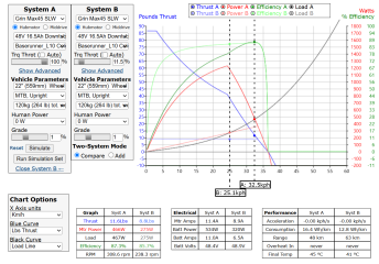

I have put in the data in the motor calculator for the standard version of the slow 45max motor with statorade vs the std version.
The version with statorade runs cooler, but uses more power and gives less range and efficiency???
A lower speed of 6-7km/h degrades range with 80% ???
Been playing with the calculator, but the results are stunning tbh.
Is it possible to limit current, or do something different when not running max. rpm?
You said you were trying to compare different motor windings, but I see different controllers selected:
Maybe you should only vary one thing at a time?
Personally, I have a Baserunner controller on a fat bike and consider it very underpowered. Max amps and max voltage are very limited. I like to go 30mph, though. If your speed limitation is true, I suppose it might be enough.
yeah i saw the difference. Accidentally selected the wron controller, but the difference is merely the same when i select the baserunner on both.
Im just stunned about the power decrease when running 7kph slower.
So, when i run it at 32kph, i get 56km of travel, and when i run it 25kph, i get only 13km out of it? Looks wrong to me?
correct picture:
Same on 36 volts...
It means that i actually need to lower the voltage to get what i need?
i'd suppose the controller would manage this, but apparently it doesnt..?
