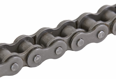

I ordered a Hairpin motor kit from Alan and everything is fine. Problem is it comes with a 08B sprocket for the jackshaft and it has been impossible for me to find sprocket for 08B chains here in the U.S. Does anyone know of a vendor that makes 08B sprockets for gokarts? I am specifically looking for one for the axle which as a 6x bolt patters in 5 1/4" with a 4 9/16 bore.
A quick google for "08B chain sprocket USA" finds these, if it's helpful:
I don't know anything else about them, though.

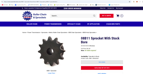

Yes I found them earlier. However, $300 minimum order . I only need 1.
Also, what does the counter shaft look like?
I may be easier to find a counter shaft sprocket with a more common chain size.
Ah, then this was very incomplete information:
as you did find those sprockets here in the U.S., but simply didn't want to spend that much money or bother to mention either of those things.
I think I'll wait to spend any more of my time to try to help you find a source until you have made a complete list of all of the places you have found and checked and a complete list of all of your exact requirements, budget, etc., so that I don't waste any of your time or mine with things you already know and/or have decided not to use. ;)
So one can either change the jackshaft sprocket from the 08B the motor comes with to a standard chain size like 41/420 or change the axle sprocket to an 08B from the standard gokart chain/sprocket sizes which are 25/35 or even 40/41. I chose to change the rear sprocket to 08B but it will need machining.
This is what I bought in the 45 tooth version. It will require lathe work in the way of boring out and drilling a 6 bolt pattern in 5 1/4" diameter but I don't believe there is a better option at least in the U.S.

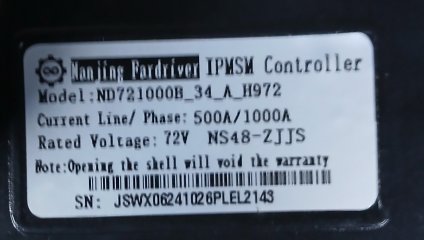

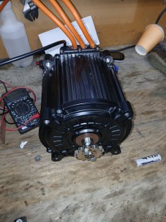

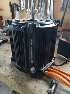

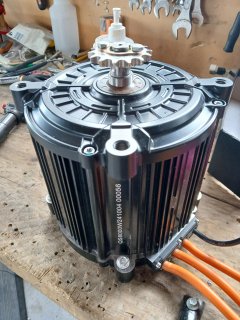

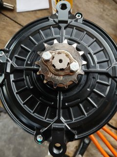

Hey all.
Qs8000w?
Fardriver nd721000B.
Any information about these would be great.
New Zealand

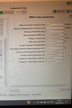

Hi @QSMOTOR, I'm trying to configure a QS273 13-inch 8000W V2 motor on a Sevcon Gen4 controller.
Do you have any test result sheets and graphs that would allow me to obtain data to characterize this motor on the controller?
