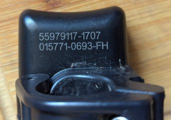

Hi.
Just that - looking for an analogue display for a Pendleton Somerby. These '790'-style units just have red LEDs to indicate assist level and battery state, but - more importantly - they communicate with the controller via a voltage change, such as 2V for Assist '1', 3V for '2' and 4V for Assist '3'.
There are countless 790, 810, G20 etc types displays that look the same, but every one I've tracked down uses UART or similar - they won't work.
(Yes, I know the alternative solution is to replace the controller and use a different display which would likely also 'improve' the bike, but the wiring in the Somerby is sooo neat that I'm loath to splice into it. Just 'power' and three wee plugs into the controller.)
Thanks.
