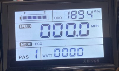

This is what my display shows (SW900). During rides, I have seen the wattage climb to 9.6 KW tops for few seconds, and it reaches 6-7 KW easily. At such KW, the speed builds up real fast and when it's 45+ mph, usually I back off.
From standstill when I apply throttle i see initial numbers like 500w, 1.2KW and it grows gradually. I guess this is the crux of the problem
The display shows Mode = ECO. I wonder whether there is a SPORT mode as well

It looks like you are running in eco mode all of the time, which is limiting both acceleration and top speed.
If you have a Sabvoton controller you need to check the wiring on your controller to see if it has 3 wires for a 3 speed switch. Some Sabvoton suppliers provide the wiring for the 3 speed option and some don’t.
The 3 speed switch wiring on a Sabvoton should be a pink, black and transparent wire connected to a 3 pin connector. Pink connected to black will be high speed boost mode, Transparent connected to black will be eco mode. Nothing connected will be normal mode. So if you find a 3 pin plug with transparent linked to black, pull it out and see if it runs better.
If you don’t have the wiring then the 3 speed mode can be disabled in the settings. But you will need a Bluetooth dongle or a pc programming cable to adjust the controller settings. These should have been supplied with the kit to the person who assembled the bike for you.
Presumably you set it to the highest pas level as soon as you switch on. Or you can just disable pas in SW900 display and run on throttle only, which may be more appropriate on your bike.

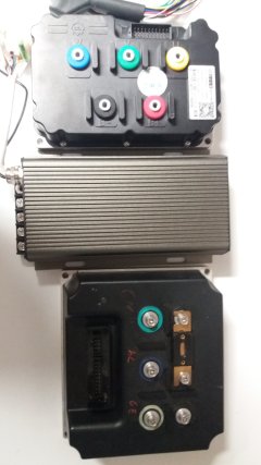

Im surprised that the person who put together the bike opted for a 2.5t with such a puny controller (assuming that its a 72150 as you stated in your other post and that its running at its limit of 350pA and 150bA) as the 2.5t has a very high kv (as was stated previously, ~17.71) which translates to something around a hundred mph at 72v with your wheel size which youre very unlikely to hit as the controller just cant push enough power for that.
This combination of a high kv and not very many phase amps is the main cause of very little torque in the low to mid end. My two cents are if you want more torque you have two options, either swap out your current 273 for a 3.5t or 4t, it shouldnt drop your speed much if at all as youll be constrained by power before you are by the wind, or, option two, upgrade your controller/battery to something that can dump way more phase amps, fardrivers seem to be what most people opt for today...something like an nd72850 would probably do the trick.
Before anything though, as it was already mentioned, would probably be best to identify exactly what controller and battery youre running to see if anything can be done there.

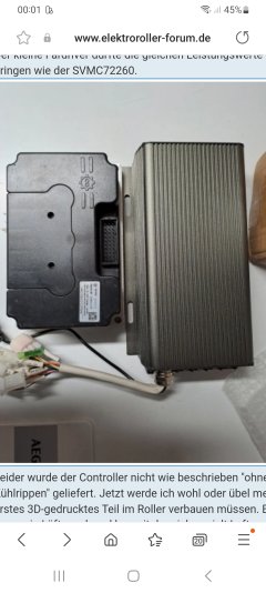

The ND72850 can do >30kw and is huge. I do not know if the 10mm² phase wires from the 4kW QS273 can handle 850A
I would vote for the ND72680. It will fit where the SVMC72150 was installed. I melted my 13.3mm² phase wires with the ND72680.
First pic SVMC72150 and ND72680.
Second pic SVMC72150 SVMC72260 and ND96850 same size as ND72850
