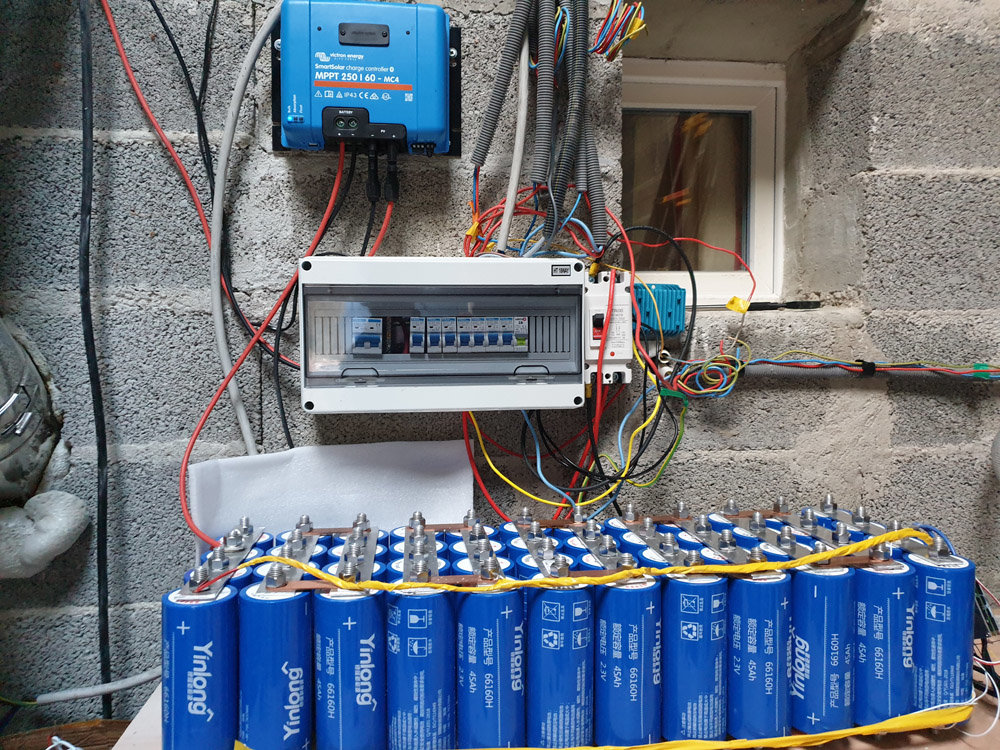

Hi all
I build a "24V" LTO battery using 12X4 cells, 45Ah each)
I added a (bluetooth) BMS ( from https://fr.aliexpress.com/item/32997552090.html?spm=a2g0s.9042311.0.0.68b86c37BAbu8z )
Here a picture :
I did this about two months ago. Here settings:
When I read cells values from phone application I see this
Notice, most of time, there is a low power consumption, only 4G router and PTZ camera.
So I was wondering about values, is difference about cells normal ?
Thanks for you opinion
And the provider answered this:
"this problem is caused by poor battery cell voltage consistency .
you need to make a good cell voltage consistency .
take high voltage cell to discharge , take low voltage cell to charge "
Either the BMS isn't balancing your pack, or you're not giving it enough time to get the job done. If your pack is in a household solar system , it may not reach the maximum charging voltage often enough for the BMS's balancing circuit to work. It takes a long time to rectify imbalances in 180Ah worth of cells at a bleed rate of a few tens of mA.

Get a dedicated balancer, just use that BMS for its protective functions, and monitoring.
Hold your AC charger at a CV / Absorb stage around 2.6Vpc or thereabouts
ideally a current rate just a bit higher than the minimum to max out what the balancer can transfer from (higher) one cell-group to the (lower) ones.
long as it takes to get the cells within about 10-15 mV of each other.

The vendor is right. You must start with cells that are closer together in voltage than what you have now. Your example shows 2.63V to 2.381. As you've discovered, that's never going to work.
I hope this analogy translates OK, but think of the 12 cells as an hourglass timer. That's a piece of glass with a two storage chambers for sand and a funnel in the middle. Start with one chamber full of sand, turn it over and 3 minutes later (or whatever the timer was designed for), all the sand has fallen from the top chamber into the bottom one.
In your bank, you have 12 hourglasses, all must start with the same amount of sand in each chamber. So when discharging, they all run out of sand together, and when you charge, that sand is put back on the opposite side. At all times, the sand on either side should stay the same relative position across all 12 hourglasses. Otherwise, the BMS will stop all the hourglasses when any one of the 12 runs out, either charging, or discharging.
We call this cell balance. It's essential for all lithium banks. The sand is measured by the voltage. You should ideally have every cell read the exact same voltage, but that's near impossible. But if you see the middle cells at 2.2V, the rest should be say 2.18 to 2.22V. That's good enough. Expect more variation at high state and low state of charge.
Fixing your situation isn't easy. What Chalo suggested, a balancer, is one option. It will take some time, and is probably the easiest option. However, if you go this route, I suggest removing it (or turning it off) once balance is restored. Otherwise, you won't know if it's making a bad cell or cells. Once in balance, the bank should stay that way for some time, at least a month, normally at least 6 months with fresh cells. Or forever if the BMS built in balancer works well. If the bank won't stay in balance, more troubleshooting is required.

Im using the same BMS on different setups, one on a 80Ah pack, and it works perfect without any extra balancing boards. You need to get the settings right, though. Can you post the rest of your settings? It looks it has shut down the balance circuit due to too much difference between cells. That is a programmable parameter. There is also a parameter where you choose at what voltage the balancer kicks in. Im using max cell voltage -0.2. So even if your cells are not perfect an drift a little at lower SOC, its still OK when they charge back up.
They are right that you should have started with a more even charge, but if you nail the settings and give it time I think it will work out.
And you should connect your temperature sensors.

Answers above. I think the "Cell unit voltage Gap Protection" is the problem for OP. Im not 100% sure, but I think there is a message in green text in the status screen when the balance circuit is active, and the balance temperature should be higher if it is active. Then again, the discharge MOS is ON, so maybe I am wrong and the balance circuit is not in protection mode, IDK. Need to see the rest of the parameter settings.

Balancing should only be done within a certain SoC% range,

200mA is way too low a balancing rate for cells that far out.
Get a balancer with at least an amp.
Or do it manually with an adjustable PSU in the 1S voltage range.

The pack is like a household solar system but ... I'm just using it 2 /15 days ! that's why it should be at maximum charge.
It's a very sunny place and, when I'm not here, only camera and 4G router are powered (some other thing are also solar powered but with independent solar system)
So I'm thinking there is two possibilities: some cells can't accept charge and limit it or BMS isn't precise.

I'm at work and far from my tiny solar "house".
I remenber I decided to to set Victron at max LTO value + a little, perhaps one or two volts more, this because I saw I was not at maximum value. Because the BMS should stop the charge too...
The small converter accept maximum (theorical) value.
Why I choose 12 cells ? because low voltage would be probably too low ... not sure.
I also bought a 24V 220V 3000W Epever pure sinus converter but I didn't connect it until now.
Honestly, unless some of the cells have huge self discharge I dont see why this would not work with the current BMS (but better settings). Bleed off group 1, 5 and 11 and set it to balance above say 2.5V, then let it sit above that voltage and do its work. As long as it stays in that voltage range it should be in balance next time you arrive. I dont know the cells, but if they are not really good matched they will go out of balance when close to empty. Then unless they are self discharging, they will be back in balance when you charge the pack up again. If the BMS has been balancing all over the voltage range, it will be a mess. If the pack needs huge current to keep the balance you have a bigger problem, IMO.
Btw, it is not charging because cell 1 has reached "cellhighprotect" of 2.7V, and the "cellhighrecover" is set to 2.4V, which is unescessary low.
