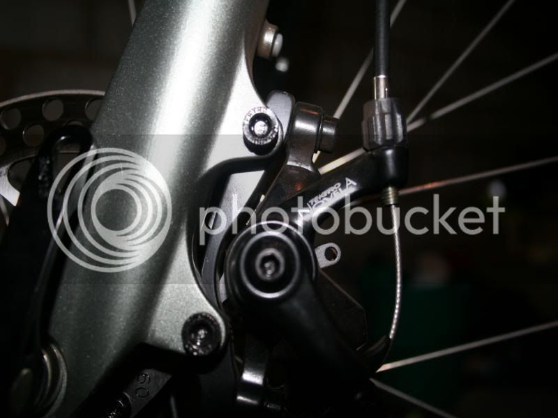

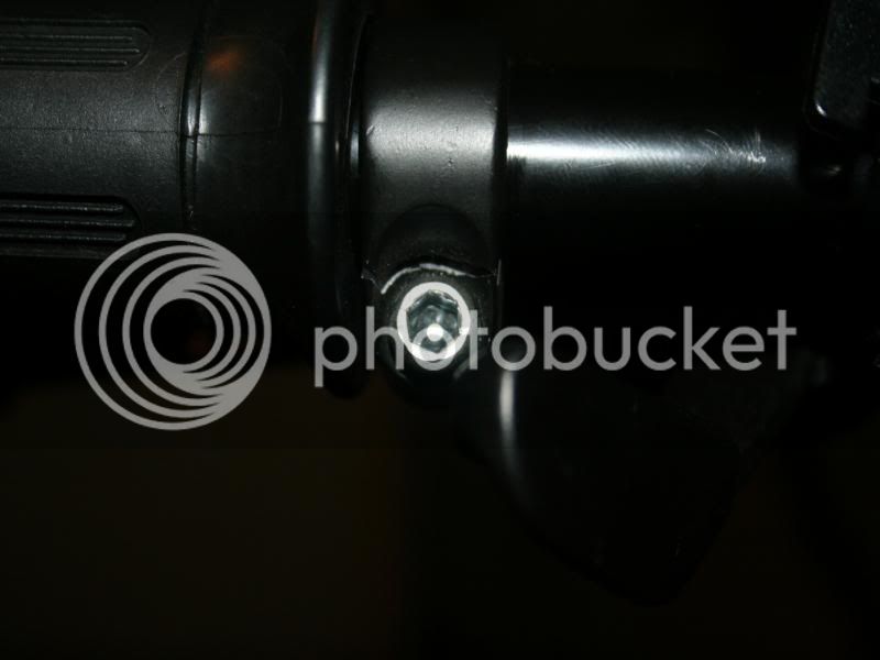

it's all done.
went into the LBS and the owner took me out the back and showed me a bunch of options.
ended up spending a bit more than i wanted, but i have now got the brakes that i feel
the bike needs. ill come back and add what type they are, the feel is heaps better than the cable brakes.
and the power of them is great too, and as an added bonus, they are quieter in operation.
the Tektro ones were a fair bit noisy. these are almost silent.
i had to get new shifters and separate hydro levers (due to cost reasons).
doing it that way was over $100 cheaper than the dual control levers.
it's all shimano stuff. probably not the greatest hydro's out there, but for my budget, they are a huge
upgrade on the cable setup.
here's some crap phone pics to show what is on the bike now.
still dunno exactly what version of the shimano hydro's they are, there's no name (apart from the Shimano logo)
on the callipers or levers. and the boxes are long gone !....
im going back to the LBS tomorrow, as they didn't set the rear gears right. the gear lever doesnt match the rear gear.
i can't select 2nd or 1st gears, and when the chain is in the 8th gear, i still have 3 clicks of gear lever left.
im sure it's a simple fix for them.
Jason.
