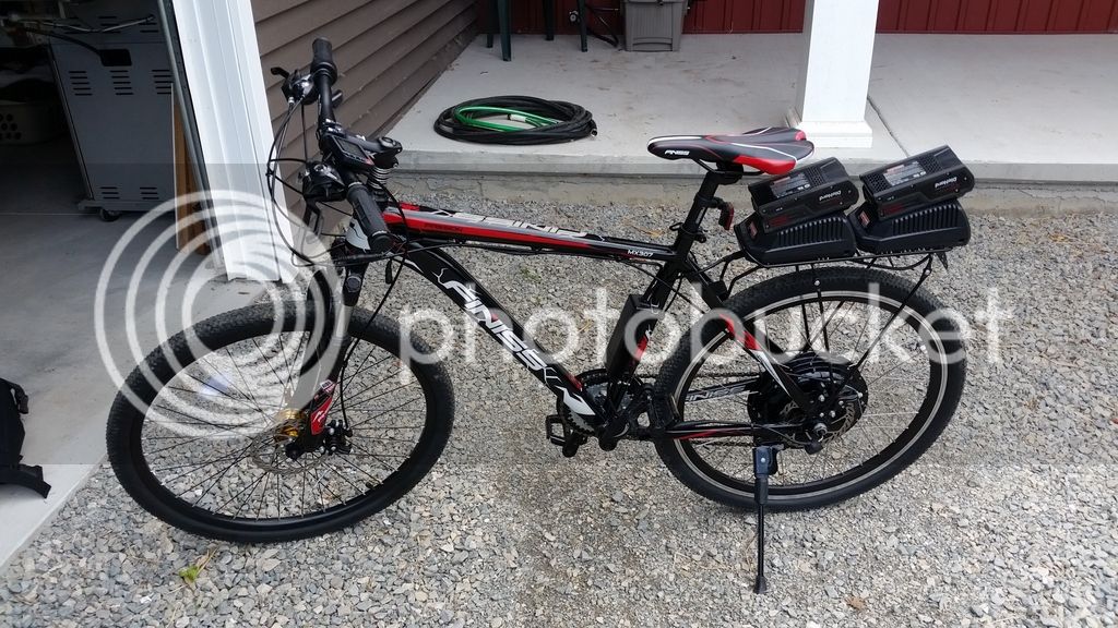

Not including the batteries, which I already had, I have about $720 into the bike. Pics!

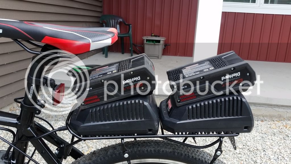

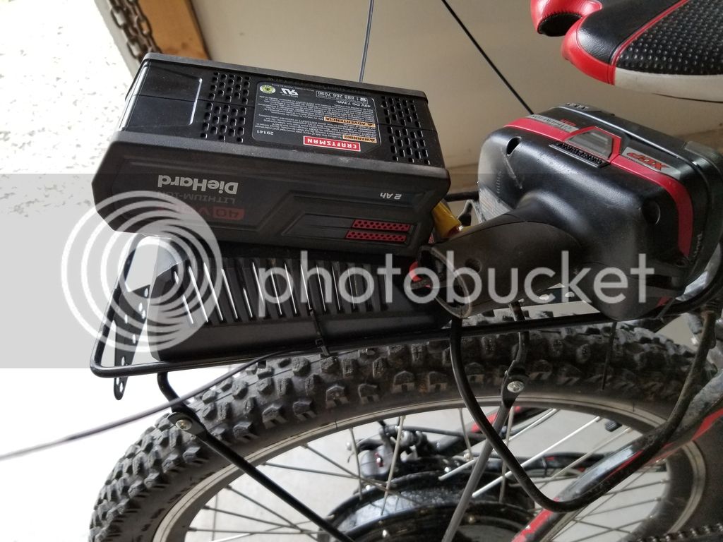

40v batteries ran in parallel. I also have 2 4ah batteries.
Replaced the OEM Tires w/ CST Rock Hawk 2.4" Wire Bead tires for mud'n.
One battery to rule them all...
