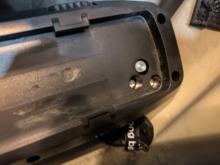

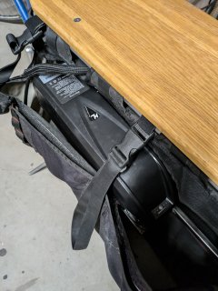

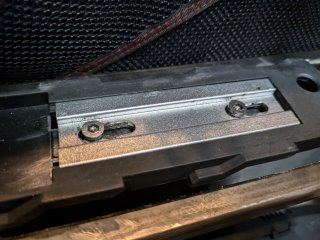

Ok, I took some time out this evening to try to figure out what's up and...I think I might have fixed it? This is one of those 'did random things' fixes and one of them seemed to resolve the issue. Time will tell if its completely fixed.
tldr: I think by filing down my m5 screws they stopped putting pressure on the battery case and that made a difference. Alternatively I jiggled something into place when I took apart and put back together the battery pack.
Fully charged voltage was 55.2V and 4.24Vc. A few hours later that was 55.0V and 4.23Vc. I spent some time going over all the wires and seeing if there were any weak connection points and couldn't find any.
So I did the whole 'go up a hill' thing and I had no issue getting up to 1000w (my cap) without it cutting it out. I did a few laps up and down the hill next to my house and it was fine. In general I was seeing maybe 5v of voltage drop tops? 55v going down to 50v. I was a bit stumped so I rolled around a bit more and got it to cut out in the areas I normally ride. These roads are bumpy and aint great. So at this point it was looking more like the issue was a loose wire on bumpy roads, not the battery. I did a couple miles on smoother roads without issue.
I then took apart the battery pack and looked inside to see if there might be a loose wire. I measured the voltage via multimeter at 53.37. The cells looked, to the best of my knowledge, like standard samsungs and didn't seem to be noname. But I couldn't see much of the cells as they were wrapped and heat shrinked etc. Then I tried squeezing and torqueing the battery pack while out of its case and couldn't get the multimeter to report a dropped voltage. The BMS was under heat shrink and really I couldn't make out anything useful without taking off the heat shrink and protective papery bits. So I shurgged and put it back together.
I then realized that the M5 screws I use to connect the downtube 'plate' to my custom mount were a bit proud...and I wondered if maybe this was the issue. I could see it wearing marks on the bottom of the battery. Long term that's not going to be good anyway, so I took some measurements with my calipers and filed them down 2mm.
Sure enough, I'm having zero problems after re-installing. The issues seemed to start when i tightened up these bolts, and I wonder if somehow this was causing some weird pressure on the wiring or BMS. I test rode it really hard to break it again but it seems resolved for now! Fingers crossed...if this holds for the week I will be shocked (in a good way! :D ).
Since pics are probably more helpful, here's some pics of the battery and the mount its on, and the now shorter M5 screws. I know a lot of this aint pretty, but it works and all my sins are hidden inside the pannier. :D You can see the wear marks on the battery...probably not great.

OK, it was a connection problem somewhere, not a battery issue. I see that you took out the Hailong pins and wired a long cable (with XT60) to the internal battery connections?
I am familiar with those Hailong cases. They're pretty crappy, at least mine were. I had one where the battery was shipped new with the BMS balance plug loose in the connector. Every time I hit a bump, the battery shut off and came back on. That was not a case problem, but the crappy part was that the battery cradle is only held by two screws, and that the battery's locking pins to the cradle only cover 40% of the battery's length,
