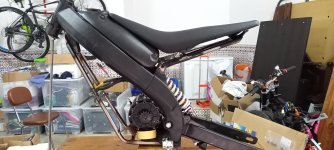

Hi everyone , just wanna show up what im doing at the moment.
Bougth a motorhispnia 50cc bike it has the same frame as derbi senda 50cc but the frame is made of steel.
My goal is try to make less heavier then original with a lill more power of course.
mortorhispania 50cc frame modified (im not a welder guy so spare me lol)
QS 4KW as direct drive with 10t front sprocket and rear sprocket 59t
KLS 7250 NR (thats what Kellys called cause it does flux weakening)
400amsp ant bms
20s 12p 21700 cells( still unknow with brand)
Wheels with rim size modified from 18x2,15 to 17x1.85 and 21x1.16 to 19x1.10
suspension from a pitbike that i have (800mm and 320mm)
