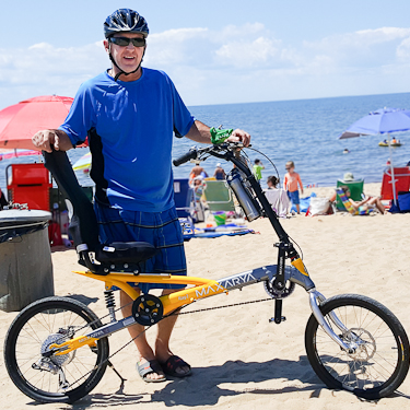

I'm kind of ruminating over what baldor said. Looking at the frame, there is no really good place to mount a motor. Because i sit with the seat fairly far back.. the suggested motor positioning is a little suspect and i suspect there will be pants to chain contact.
Let's be honest.. the bike is hard to electrify!

Lol, he wanted an electric racer (he did a lower powered one), and it would be actually better (AWD!) but to be viable as a *racer* it would be MUCH, much more expensive compared to pulling a motor from a donor bike...
A belt drive would help with the pants shredding factor but creates the need for custom 'sprockets' of particular offsets/sizes. Not worth the hassle and money.
The electric Ray 2 is the least appealing electric bike i've ever seen. Battery on the handlebars is ugly, becomes a flammable front bumper, and creates steering effects and probably some extra wear and tear on the headset.
Because of the weight distribution issue on the maxaraya ( i easily do wheelies on pedal power ), in their electric version, the battery acts as ballast to keep the front end on the ground.
Best thing we can do is put the battery and motor up front as far as we can. That always means using a mid drive.

How about, on my bike, putting a mid drive in the middle mid drive section ( Hey, it's a 68mm BB! ) and converting the pedal drive side to drive the right instead of the left.. ?
There are also chainring adapters for the BBS02/HD, maybe tongsheng also, that bring the sprocket inward and (probably) give me enough room to adjust the driveline offset.
That begs the question.. which mid drive has the least extra width, or most correctable extra width on the drive ( right ) side?
I think the battery on the Maxarya's steering mast is probably the least of the factors that would make it ride badly. It looks to me like the frontmost part of the battery is half a meter behind the frontmost part of the bike, so not a bumper unless you nail a railway crossing gate. It's set at a minimum distance from the steering axis, so it should have less inertial effect than a sack lunch and a water bottle in the handlebar basket of a normal bike. I would not be very surprised if a 'bent were debilitated by that, though.
Given what headsets do to manage contact patch forces, I doubt any of them will notice an extra ten pounds stuck on a stick. However, if that's a folding joint for the steering mast I see, it might get beat up by the added bending moment.
My biggest beef with the battery location is that it's up pretty high, so when the bike falls over, the pack could be moving fast when it strikes the ground. But there are plenty of worse things about the bike than that.

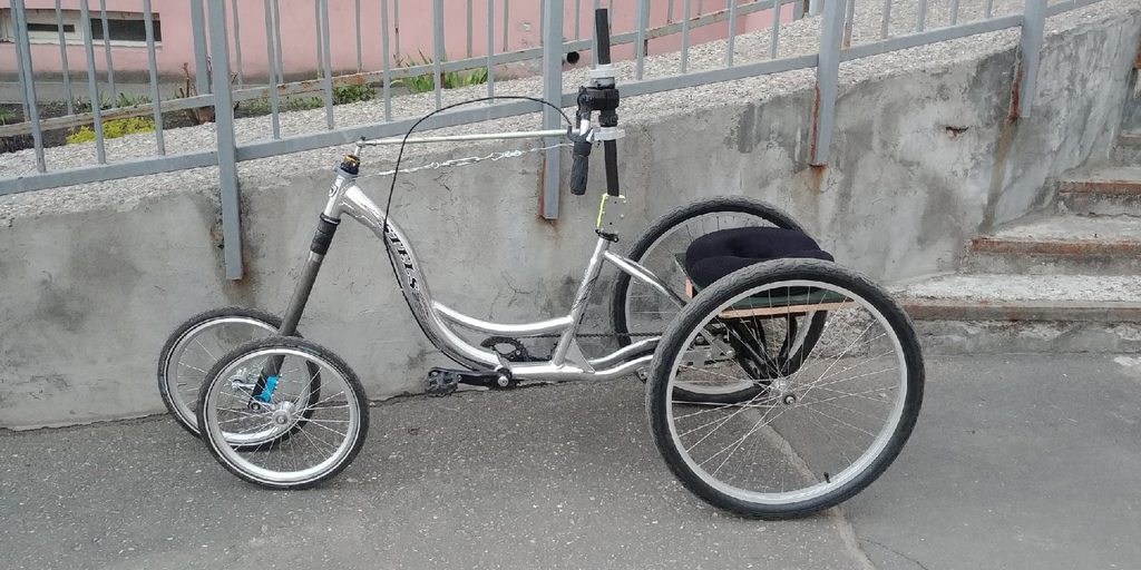

Since I'm personally very clumsy, I've had to learn a LOT about it and design my own bents around my personal limitations from basic principles...
No, i didn't exactly measure it, maybe i'm exaggerating and it's 80%-20% :lol:
Yeah i noticed the maxaraya had a tiller effect right off the bat with it's handlebar design and angles. I immediately chucked the entire setup and went to wide BMX bars. Dramatic instant improvement. Very wide handlebars also makes the bikeE a joy to ride despite having a silly size front wheel and short wheelbase compared to these big bois.
That trike doesn't look fun, let's say!
I had to learn a lot of new things since getting myself into CLWBs, Laid back bikes are a completely different world.
